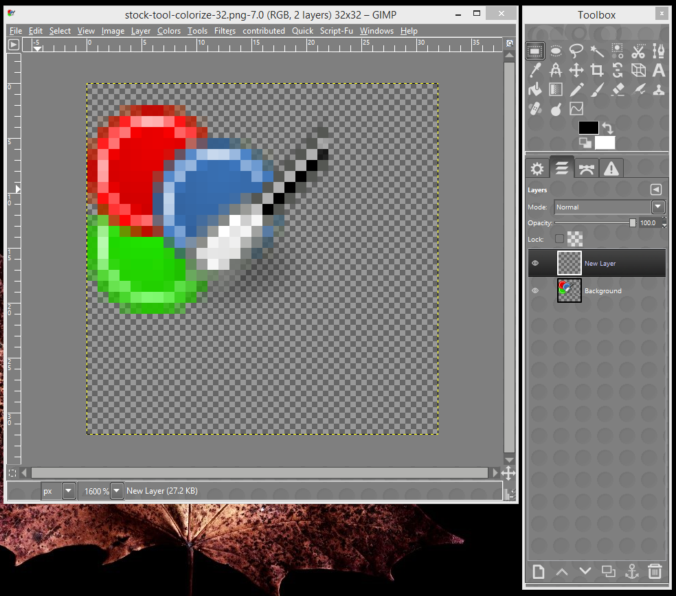

It's a fair point about explaining my work-flow...
I start by opening one of the existing 22x22 sized icon files, setting the canvas size to 32 and adding a new 32x32 transparent layer and zooming in a lot.

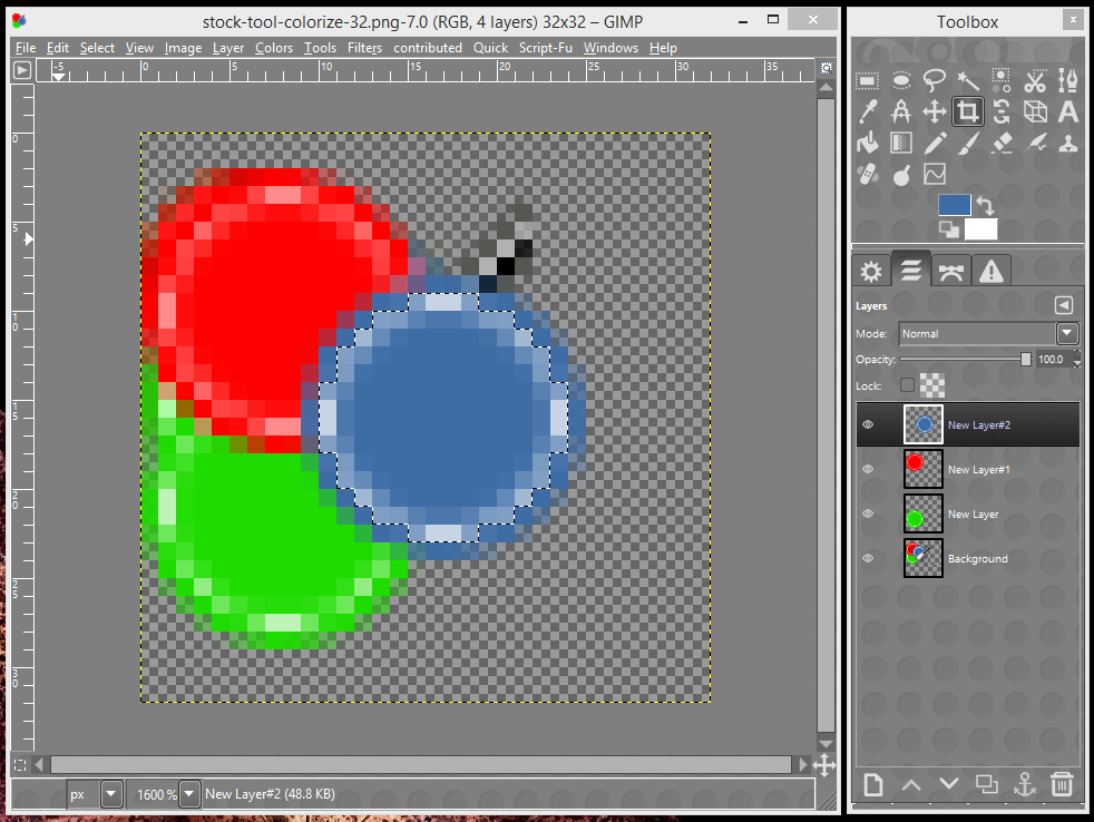

Now I analyse what it I'm trying to make a larger version of - in this case three circles and a palette knife(?)
So circles are easy, and the green is obviously underneath, so I draw that first, then the red, then the blue
each on separate layers in case I want to move them.

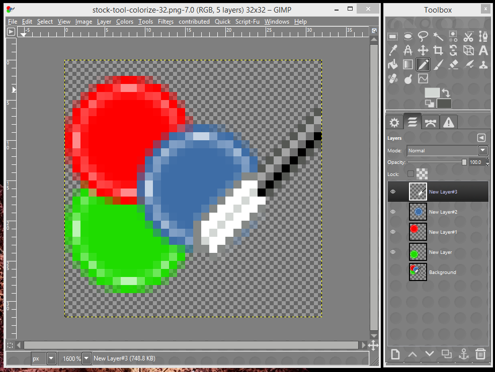

Now I've got to draw the palette knife, so it's back to the layer with the original icon on, and see how it's drawn - it's got a black handle with a grey highlight on the top edge and a mostly white blade, outlined in grey to make it stand out. It's drawn on the diagonal and reaches from the bottom of the blue circle to the edge of the layer.
Now it just a matter of drawing those pixels - one pixel at a time if necessary.
I've not been bothering with the drop shadows.
And that's all there is to it.
Kevin

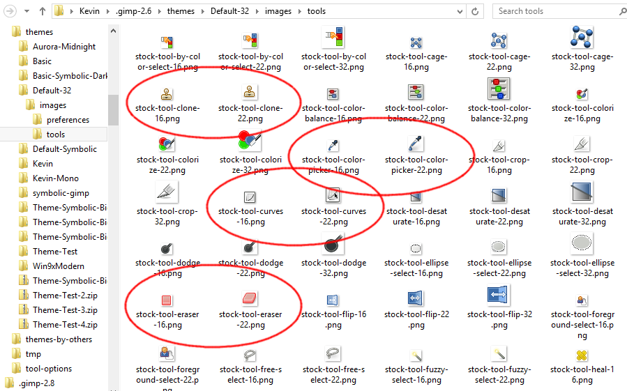

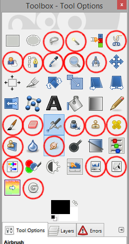

If you download the .7z from my repository, you will find this:

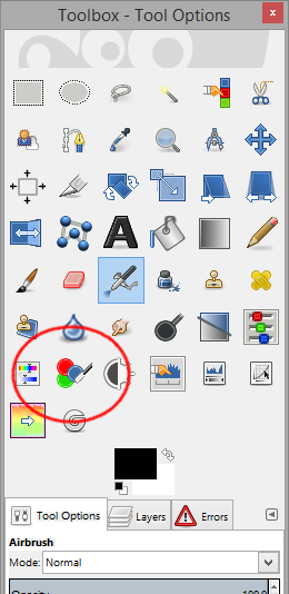

and you're looking for icons that don't have a -32 version.
An alternative way of looking at it is this: All the circled icons don't have a 32x32 sized version.
Kevin
