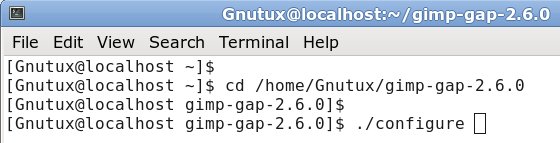

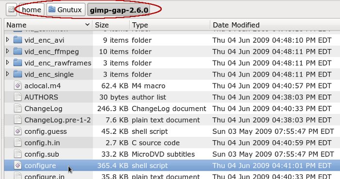

You change directories from within the terminal. You must change directories into the gimp-gap-2.6.0 folder and execute the ./configure command from there.
For example, my gimp-gap-2.6.0 folder is located in my user folder (Gnutux). You will need to change into the proper folder location on your system (wherever you extracted it).
I can change into that folder by entering the following cd command in terminal..
cd /home/Gnutux/gimp-gap-2.6.0 <enter>
You'll notice the terminal prompt now displays the current folder: [Gnutux@localhost gimp-gap-2.6.0]$
Execute your ./configure command from there (after you'll installed all the tools and libs I listed).
