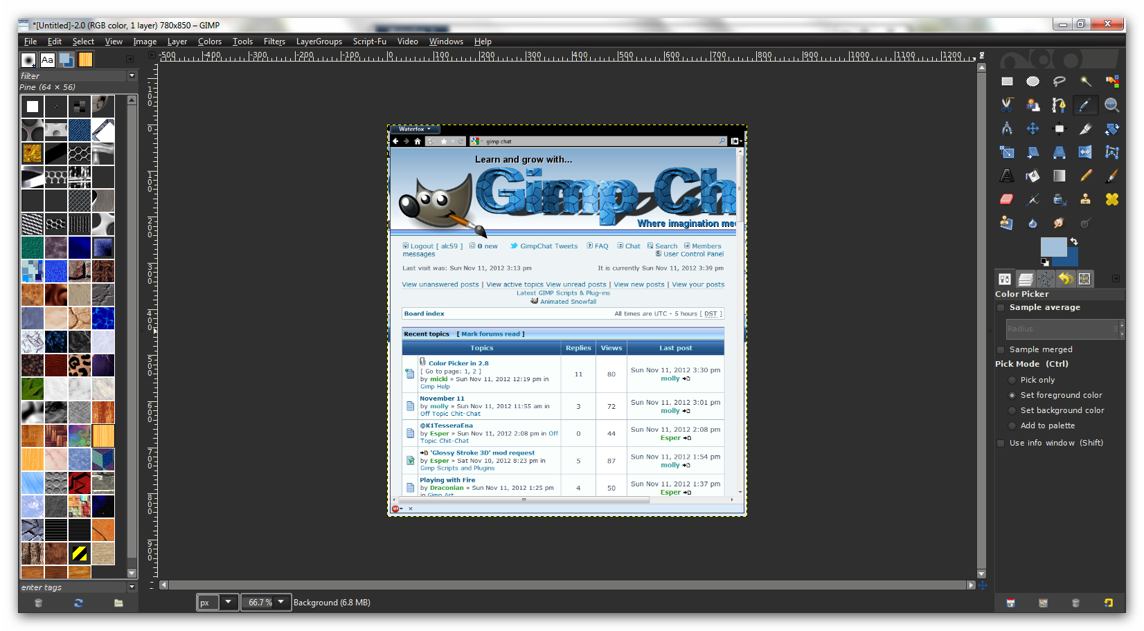

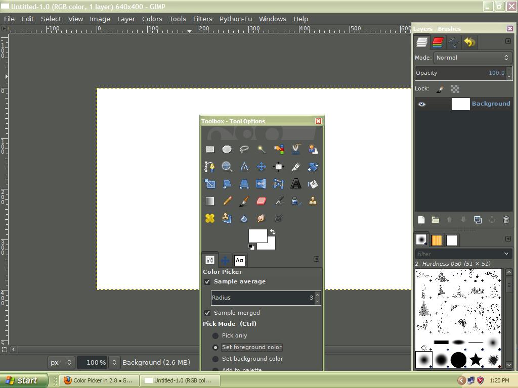

Do you click the two green lights that shows in this screen shot before you pic your color? [ sample merge and sample average]

When you click your color picker, down below will see the dialogue. You will see where your color selector is selected and down below is your dialogue for that tool you will see the 3 light green lights that have been selected.

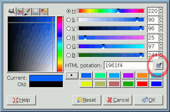

Instead of using the Color Picker, you might try using the eyedropper in the Color Selector dialog. This will allow you to pick your color from anywhere on your display.
There are two ways to access this "full-screen eyedropper":
you can explicitly open the FG/BG Color Selector dialog using "Windows->Dockable Dialogs->Colors" (this dialog can be permanently added to one of your docks if you wisht)
or you can use the Color Selector dialog that opens whenever you click on any one of the "color swatches" strewn about the GIMP's interface (e.g., the main FG/BG chooser in you Toolbox, the color selector for text, ...)
In either case, the "full-screen eyedropper" is accessed with the button that I circled in red in the above screenshot. After clicking on that button, GIMP will wait for you to click somewhere on the screen, and then your foreground color will be set to the color under the cursor. After picking your color, the cursor returns to its normal mode.
Unfortunately this seems to be broken on (some ?) Windows operating systems and will always return black, so the Color Picker tool is the only way to go, and as it will only pick colours from within GIMP image windows, you will have to do screen grabs.
