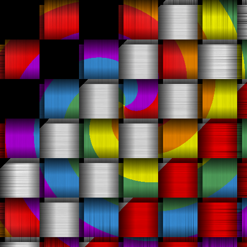

PostPosted: Sun Feb 27, 2011 3:01 am  (#6)
This is what I did. Opened two images as layers. Ran the weave filter using ribbon width of 70 and shading width 10.
Adding those together to get 80, I made a grid using 5 for the w & h on the lines and 80 for the spacing. It worked out fine. I rendered the grid on a new transparent layer.
Then I selected every other square using the fuzzy select tool, Grew the selection by 2, deleted on the top layer.

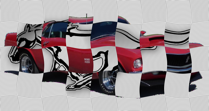

Oregonian wrote:
Lyle, you mentioned mask, and I thought aha! Render > Patterns > Checkerboard. Use as a mask on one layer. Works! I used 80 as the check size.
And if you ripple it a bit it gives interesting effects:
ofnuts, that's brilliant. I love it.
 Post subject: Re: how do i weave two pics together like a basket?
PostPosted: Sun Feb 27, 2011 10:32 am  (#14)
Come to think of it, I wonder why I took so much time doing synchronized ripples on both pics plus the mask, in the end I could have made a square picture and applied the ripple filter once :) Normally my laziness takes the better of me.

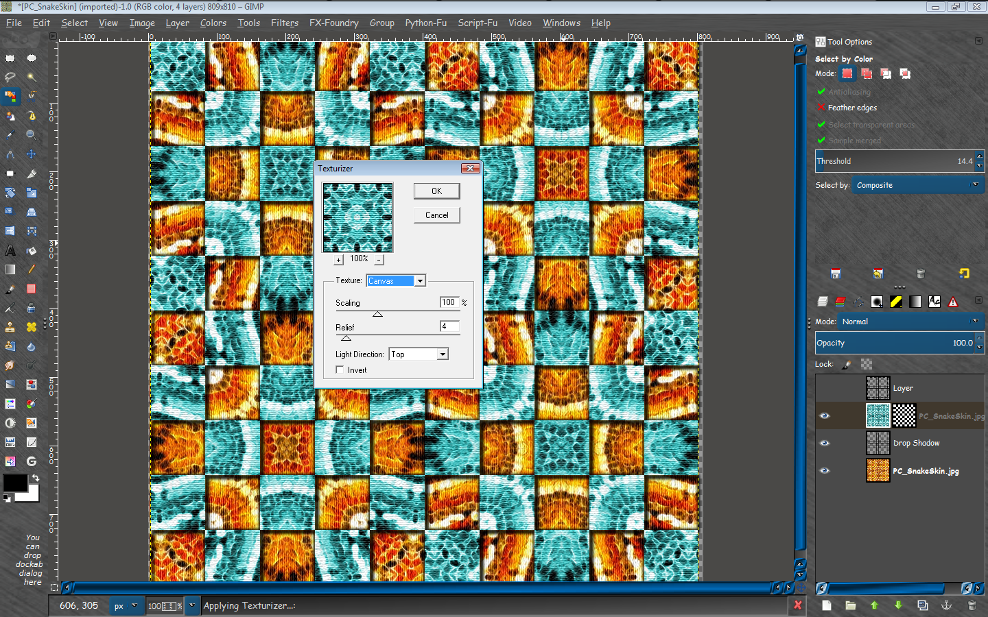

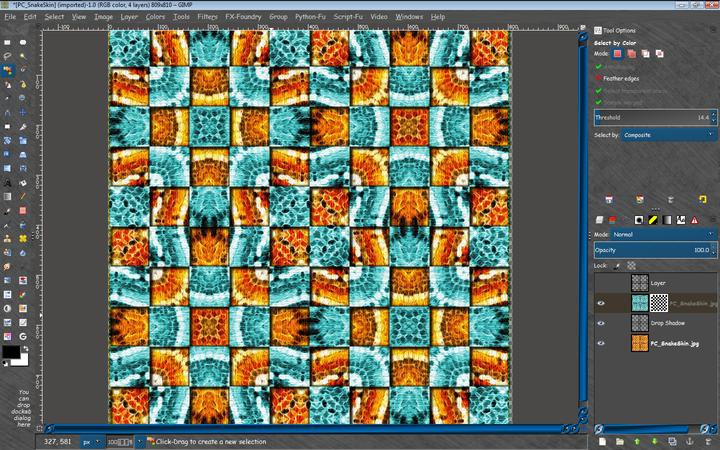

Open 2 images in GIMP
Make a new layer name it checkerboard mask
Make a checkerboard >Filters>Render>Pattern>Checkerboard (This one is 80 in size.)
Duplicate that layer
Right click top image layer and add layer mask (white full opacity)
Select the mask with the mouse (just click the mask rectangle on the layer)
Edit copy checkerboard, and Edit>paste into layer mask.
Now is the tricky part.
Select your duplicated checkerboard layer and using the color select tool select a black square in the checkerboard pattern.
Now all black squares are selected.
Go to Select>Border and select 3-5 for size.
Go to select>invert and edit clear.
You should now have a grid of black lines.
Go to Filters>Light and Shadow>Drop Shadow and add a drop shadow
offset x and y - 2
blur radius - 5
color - black
opacity - 85
allow resizing
Make the duplicated checkerboard layer invisible.
Place the drop shadow layer under the first image that contains the mask.
You can optionally use canvas to create lines in the images.I used my Adobe filter texturize.
Workspace file attached (XCF)
