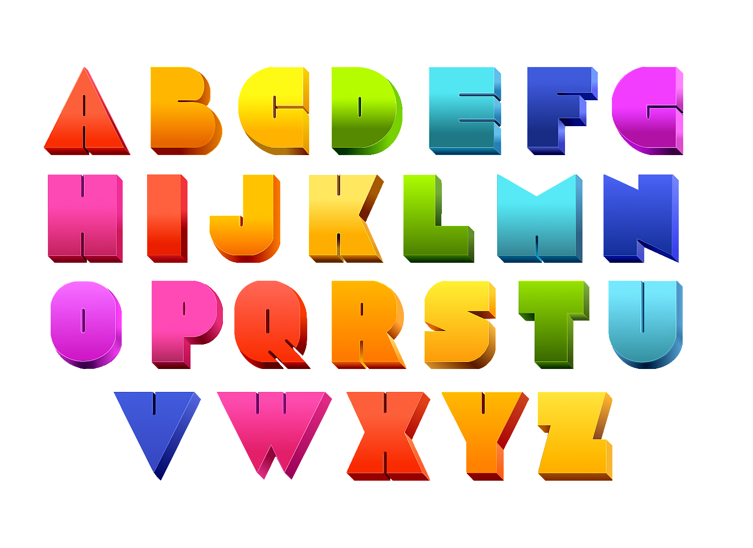

 Post subject: Re: Custom Font script (spawned from Wallace's PhotoFont topic).
PostPosted: Fri Oct 21, 2016 10:48 pm  (#274)
Posts: 14281
I finished this font,
but I'm having issues with setting it up to work properly with the Custom Font script.
If anyone wishes to tackle making the font xcf file,
please feel free to do so.
I made a test of this font and it's seems to render out very distorted.
Not as crisp, with the rounded off edges.

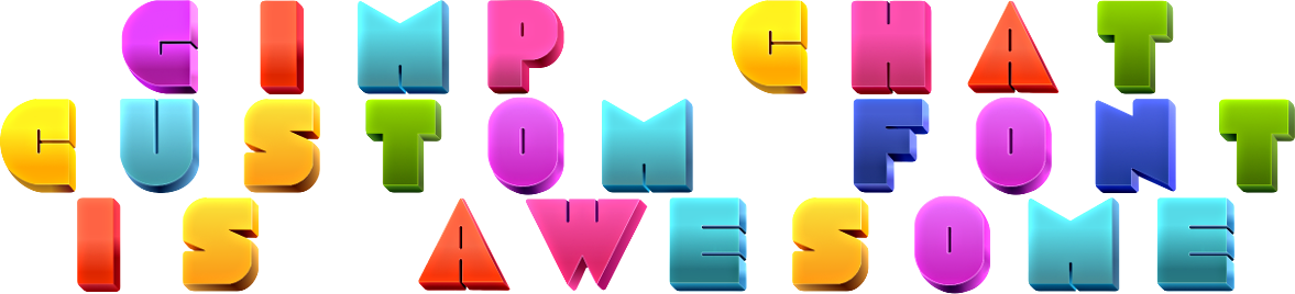

PostPosted: Fri Oct 21, 2016 11:16 pm  (#275)
Posts: 16298
I see the problem with the script now. It doesn't allow overlap of transparent areas. It lines every character up according to border width. Tran is there a way to allow overlap of layer cells? Setting kerning isn't going to work because all the other letters are already close as you can see in my example image below.
The XCF font file is attached Wallace. :)
Rainflow_2.xcf [902.9 KiB]
Downloaded 170 times

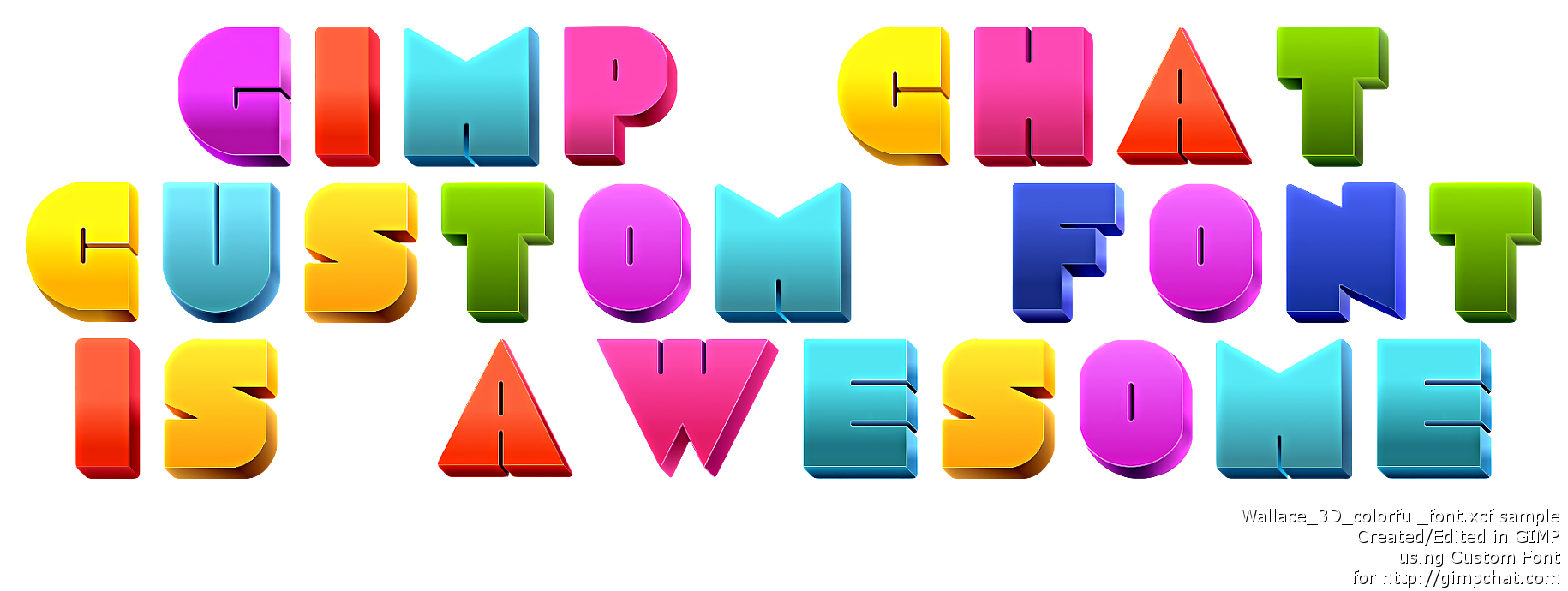

PostPosted: Fri Oct 21, 2016 11:30 pm  (#276)
Posts: 4561
Here's the .xcf.
I was really quickly done with the help of "Break apart by alpha"
Wallace_3D_colorful_font.xcf [940.15 KiB]
Downloaded 106 times

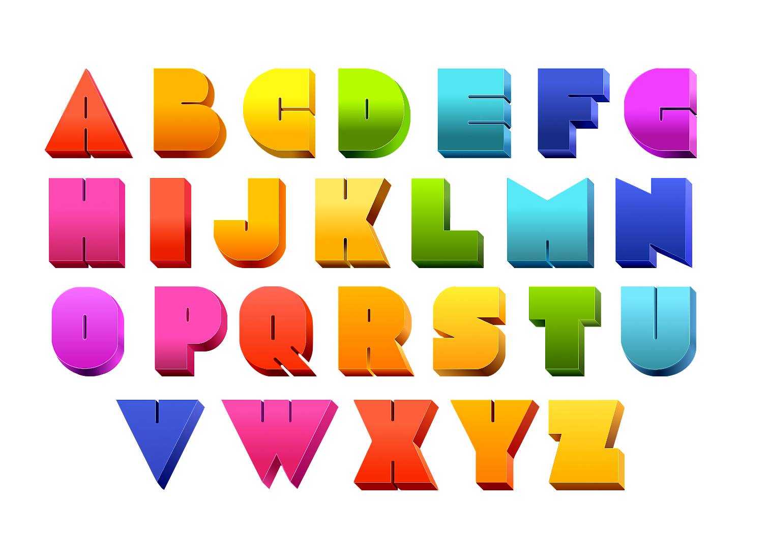

PostPosted: Fri Oct 21, 2016 11:31 pm  (#277)
Posts: 14281
The attachment Rainflow_2.xcf is no longer available
That looks very crisp and clean. :bigthup
How did you get it so crisp?
I did an even cleaning render of the this font and here's the image.
Rainflow_2.xcf
I didn't do anything to it.
I just broke a part by alpha change canvas size to be 20px wider 20px taller and center them all and selected the whole canvas with rectangle select
then used "Layers auto crop resize to selection height"
and that's it i didn't change any content.

trandoductin wrote:
Here's the .xcf.
The Break apart by alpha,
rounds off the edges of the font.
Making it rounded ,
instead of how it was designed,
as a sharp edged font.
I'm guess it should be done without using Break apart by alpha.
To have the font edges not rounded off?
