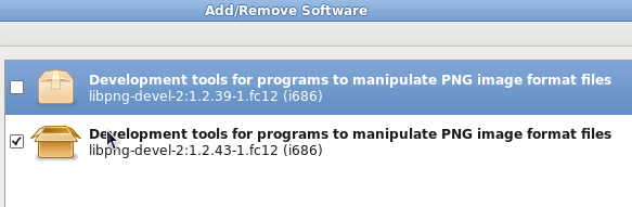

Please check under System/Administration/Add/Remove Software to see if libpng-devel is installed.
 Post subject: Re: GIMP has an apng plugin!
PostPosted: Mon Apr 26, 2010 10:31 am  (#10)
Yep, it is.
Strange it would say it's not available instead of already installed.
PostPosted: Mon Apr 26, 2010 10:38 am  (#11)
Unfortunately, I don't see anything in this changelog that denotes that the libpng-devel for F12 has been patched to support APNG.
Looks like we will have to manually patch that devel lib to support apng (or find a pre-patched version).
