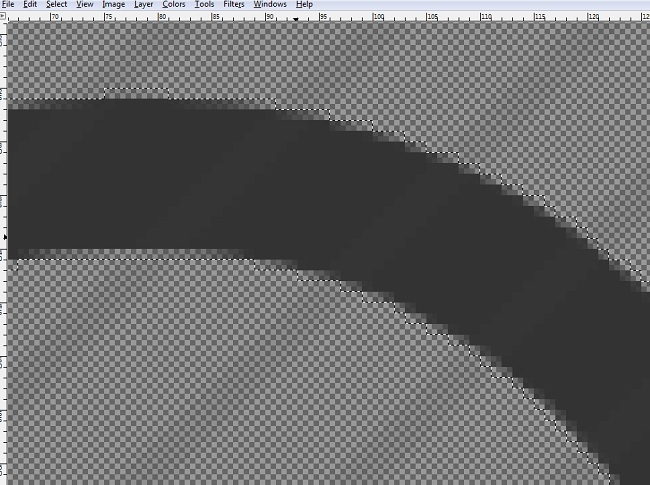

I am trying to change the image to a different color but what happens is it gets a bit pixelated because of the outer pixels as shown in the attachment.
I am not sure how to make it look smooth.
I am sure it could be a simple job for more advanced users.

lock the alpha channel before painting/filling to preserve the semi transparent pixels.

Have you tried using color>map>gradient_map
That works quite well, Never knew about it!
Getting some good results with that!
