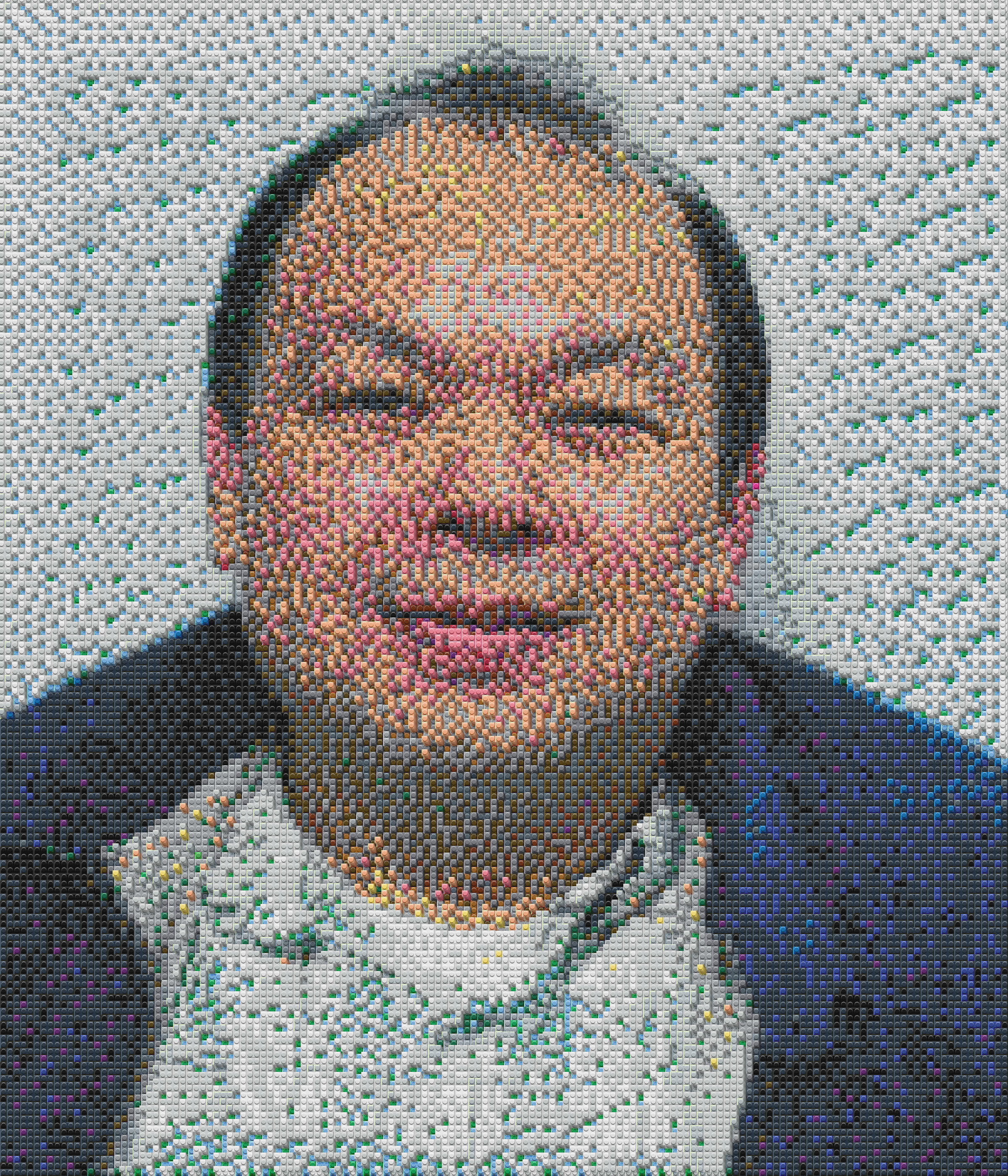

Posts: 12850
OK; had a brain fart and figured out a way to get the selections (still convoluted, but doable). Now I can do a better job at creating 3D Legos but now the lego pieces won't a have the seams that the original tute (don't ask me the link; way too lazy to find it) had (i.e., you can have distinct pieces like right angles, multiple lenth straights, vertical and horizontal, etc.). :)

Posts: 12850
Yup; now on a Legos binge again. lolol
ref: http://www.fontplay.com/freephotos/seve ... 107-08.jpg
