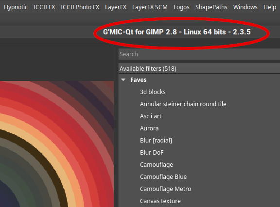

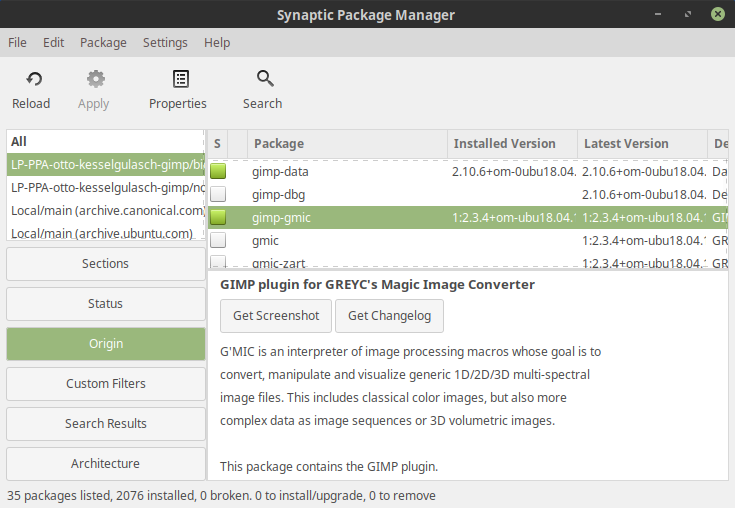

None of the G'mic standalone plugins work here in Mint 19 (ubunto 18.04 bionic) I either have to install the DEB file or this plugin via the package manager. My version of G'mic is 2.34
