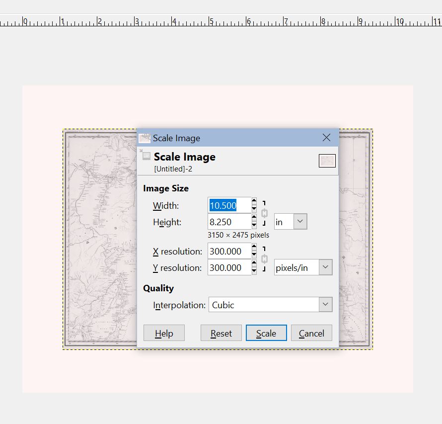

my new is sized 10.5 inches by 8.5, i opened a new image file as a layer, and it comes in at 8x6, and when i try to scal it, nothing happens. I looked on youtube and watched a video and looked at the manual and i believe i followed the instructions. but the image remains the same size after i scale it. I do not want to drag the corners to scale it to the full size.
ok the first pic is before and after the scale, the second is the scale.

Hi iti. If you use "Scale image" the whole image will scale, that is including the background. You need to use the "Scale tool" to make as big as your background.
 Post subject: Re: Scale doesnt seem to work
PostPosted: Thu Jun 25, 2020 11:24 pm  (#3)
As Pocholo suggests, be sure to check the image icon in the tool options dialog.

In this situation I would personally use Layer/Scale Layer.

As I said, try Layer/Scale Layer instead of the tool you are using.

Your layer needed to be centered after resizing. Unfortunately I cannot post it here because the max. attachment size is 6 MiB. Resize the layer using Layer/Scale layer, then use the alignment tool to center it.
