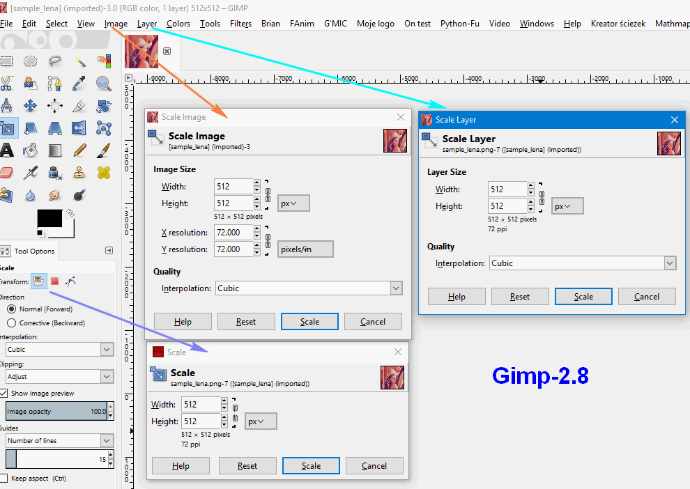

For Gimp-2.8 it looks a bit different than the Mahvin dump (for Gimp-2.10 ;) )

In this situation I would personally use Layer/Scale Layer.
Thank you, so use 'selection'
I still get that transform pop up window and not that little window you show where you just type in the size. Im so frustrated now. apparently gimp learning gimp is not intuitive at all. Why does it give that big transform window first instead of a simple window like you show where you could just click advance if you wanted the other one. Yeah, i have been telling everyone to get gimp and support them im not doing that any longer. this should be a very simple task. ive now spent 2 days and i still cant resize anything!

As I said, try Layer/Scale Layer instead of the tool you are using.

Your layer needed to be centered after resizing. Unfortunately I cannot post it here because the max. attachment size is 6 MiB. Resize the layer using Layer/Scale layer, then use the alignment tool to center it.
