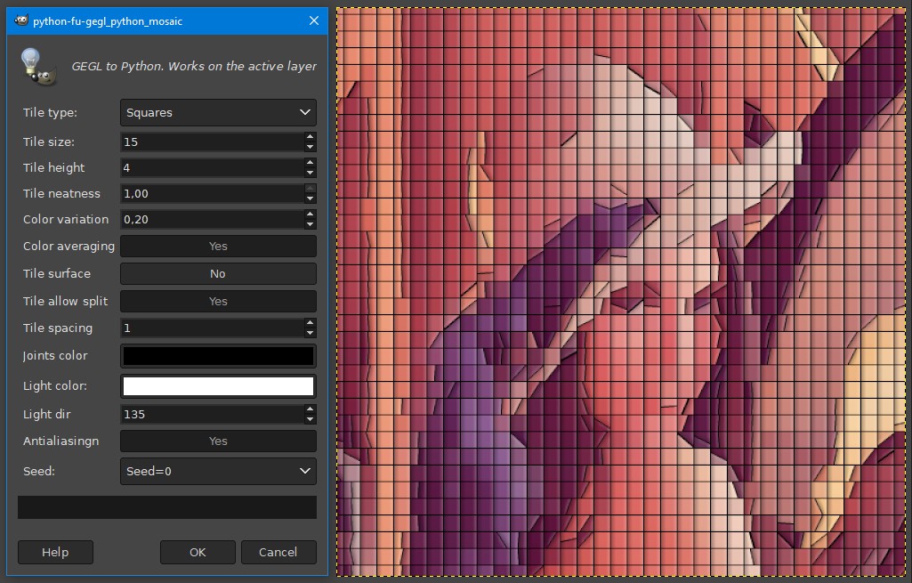

PostPosted: Mon Nov 20, 2023 3:39 am  (#41)
Hi Diego
Thank You for reporting the error.
In line 1798 the letter s is missing
Change: tile_type_m= "square"
to: tile_type_m= "squares"
For those writing programs in Python/Gegl, my observation: if the value of the enum type is incorrect, Gegl will adopt the default value - clever for operation, but makes it difficult to detect the error.
The fix will be included if I write a few more plugins, I will update the download to the next version (including Bump-map for Linux and likely other bugs).

 Post subject: Re: GEGL operations exposed to Python-Fu - WIP 72 ops wrapped
PostPosted: Mon Nov 20, 2023 4:09 am  (#42)
Thanks. Applied the suggested change. Problem of type solved.
But what about the problem of neatness?
Whichever value you enter from 0.00 to 0.99 the resulting neatness is always the same.
PostPosted: Mon Nov 20, 2023 5:14 am  (#44)
Thank you again.
I acknowledge my stupid mistakes. :oops:
Replace this:
line 1742 opacity=%d ➤ opacity=%f
line 1815 tile-neatness=%d color-variation=%d ➤ tile-neatness=%f color-variation=%f
line 1870 elevation=%d waterlevel=%d ambient=%d ➤elevation=%f waterlevel=%f ambient=%f
This may be useful:
%d - will reduce to an integer,
%s - will keep formatting,
%f - will display as floating point
%g - is used as a general number
