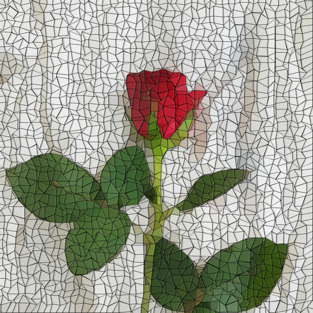

Now I have a different question:
it seems that the filter called from GEGL as Python produces a neatness different from
the filter called from inside my personal test.
I attach here:
- my test program
- the result from GEGL as Python
- the result from my test program
DIEGO_MOSAIC_GeglMosaicTEST.7z [976 Bytes]
Downloaded 1675 times

 Post subject: Re: GEGL operations exposed to Python-Fu - WIP 72 ops wrapped
PostPosted: Mon Nov 20, 2023 10:21 am  (#47)
Comparing with the original Gegl:
From a quick analysis:
Your filter has an incorrect tile-neatness value.
PostPosted: Mon Nov 20, 2023 10:41 am  (#48)
Thanks for your test.
In my filter neatness is the parameter regularity and is passed as 0.65 in the "neatness" position, as you can see in the filter code.
I've seen that it is NOT taken into account. But why?
