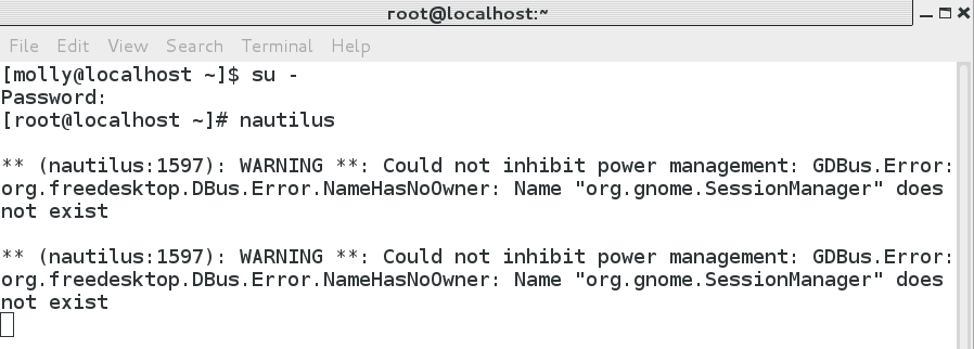

Ok, here is what I did. I went to terminal/root/Nautilus. I then went to my mathmap/expressions folder. I tried to take out the "Extra" folder and received this error.
I then rebooted and tried again and received the same error. I proceeded to open the extra folder and removed the "mm" files from inside and placed them into the "Map" Folder.
I then opened Gimp/Generic/Mathmap/Mathmap/Filters/Map, and all the files from the Extra folder are there and they work. (The empty "Extra" folder still resides within the expression folder).
So now I have the plug-ins I want and a terminal that is throwing errors. :roll:

Really pleased you have something working. Your nautilus error message - well I put Fedora17 on an old laptop to give it a try and some bug there with power management. More lock-ups in a few hours than 6 years of Mepis/PCLOS.
edit: try in a terminal
su - -c nautilus
Glad to hear you are able to access the extras. You can use the zip file in PC's thread and copy the .mm & .mmc files directly into your existing folders. The only "new" folder there is the animation folder so you'll need to deal with the files in there if mathmap doesn't see the new animation folder. You might have to copy those into an existing folder as well.
You can ignore those nautilus warnings when running as root. It's normal to see warnings when running apps from the terminal, especially as root.
