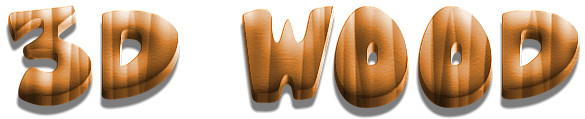

I like text effects very much!
Today i found out how to get a funny 3D wood text-effect.
You need no extra texture or a special script.
Did you know that motion blur can produce a 3d-effect? Read the tutorial now! ;)
All you need is GIMP 2.8 out of the box!
Please show me your results, i want to see them! :)
You can create this text style then:
3d-wood-text.pdf [1.03 MiB]
Downloaded 2132 times

Molly: please ignore the name of the bumpmap-layers in the screenshots.
Thats old names from my original document. I was testing some blur.
You should have the original text, three blur-layers and the solid noise-layer.
Use two (gaussian/motion) of the blur and the other from the solid noise layer only for that original text.
First, the gaussian for make the text round and .
Second, the solid noise (not too much) for the texture.
Third, the motion blur for the 3D effect.
Thats all! :)
Esper: Yes i really like your outcome! I happy to show something new for someone! :)

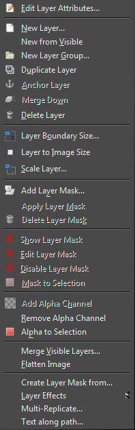

Molly for layer attributes 'right click' on the layer and it's at the top of the drop down menu list in 2.6 and 2.8

nice job guys... Graechan, I don't have layer attributes. I haven't had them since 2.6

Molly (head scratcher) they are there in my 2.6 2.8 2.8.2 and 2.9 try double clicking on the layer name and editing then press enter, maybe it's a penguin thing

Graechan, you know I always have to be different. I knew I didn't have it since 2.8 first came out because I noticed it when I wanted to rename one of my layers and it wasn't there. :teeth
 Post subject: Re: 3D-wood-text
PostPosted: Mon Feb 18, 2013 7:20 pm  (#18)
Molly did you try double clicking on the layer name and editing there
PostPosted: Mon Feb 18, 2013 7:24 pm  (#19)
Nope, it doesn't work. I have been all through the preferences and all the drop downs and no dice. I even tried Google.
