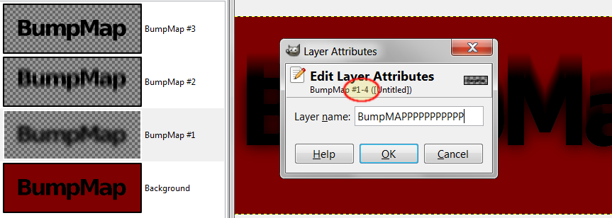

molly, there are several ways to make your bump map layer noticable
one is to name the layer in a way you will easily be able to distinguish
for instance i call my BumpMaps something like BumpMapPPPPPPPPP
also there is a number in the Layer Attributes window, that you can write down and easily find in the BumpMap dropdown menu

Edit: I don't know where you get Layer attributes. You must be still using Gimp-2.6. I can't see it anywhere in 2.8.2

Molly for layer attributes 'right click' on the layer and it's at the top of the drop down menu list in 2.6 and 2.8

Molly (head scratcher) they are there in my 2.6 2.8 2.8.2 and 2.9 try double clicking on the layer name and editing then press enter, maybe it's a penguin thing

Graechan, you know I always have to be different. I knew I didn't have it since 2.8 first came out because I noticed it when I wanted to rename one of my layers and it wasn't there. :teeth

Molly did you try double clicking on the layer name and editing there

Nope, it doesn't work. I have been all through the preferences and all the drop downs and no dice. I even tried Google.
