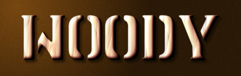

more woodwork:
i did this with motion/blurred channels and tried to use the same bumpmap values regarding angle and azimuth, the clouds were the usual layer
